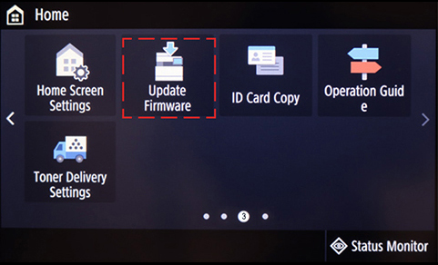

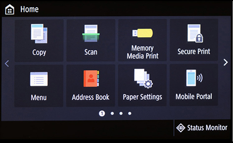

Step 1: Update to Latest Firmware
  • From homescreen 1, press on right arrow to get to homescreen 3 and press Update Firmware icon
  • Install firmware update (if applicable)
  • You will see a notification confirming that your firmware version is the latest available
  • If a firmware update is needed, your device will power off and restart once the update is complete

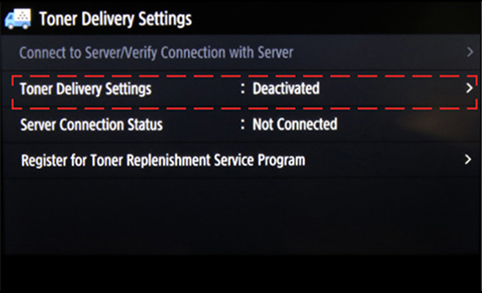

Press Toner Delivery Settings icon Homescreen 1
Press Toner Delivery Settings: Deactivated Homescreen 3
*Placement or actual screen may vary

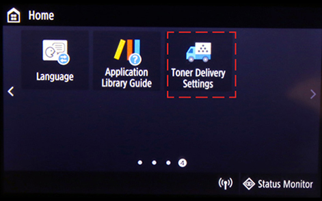

Step 2: Activate Auto Replenishment Service
Follow on-screen instructions if prompted. If a prompt does not appear, follow instructions below.
Press Toner Delivery Settings icon Homescreen 4

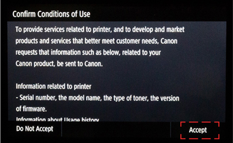

Press Accept to continue

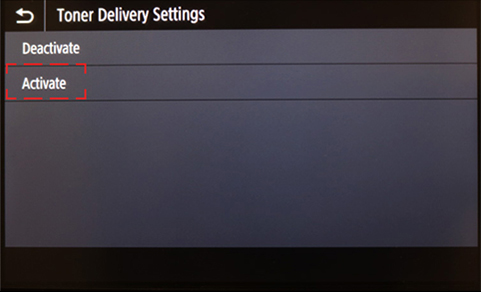

Press Activate to begin setup

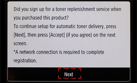

Press Next after reading first validation step

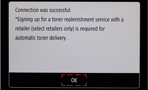

Step 3: Final Validation Steps
Next, you should see screen validation below
  • Press OK

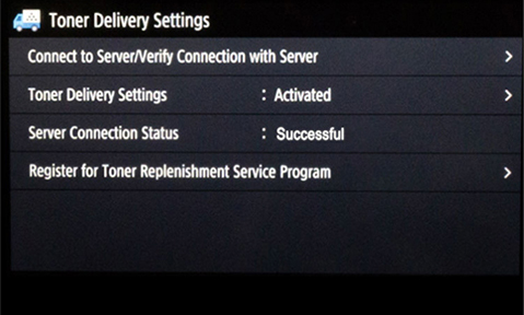

  • Check server connection status. You should see the following Server Connection Status: Successful screen.
    If an error message occurs, follow on-screen instructions
Once your device is activated and you see the screen above,
please click Continue.
